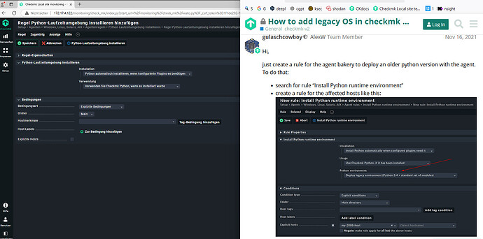

I wish to monitor a legacy OS, namely a Windows Server 2008 R2 but i am facing the following issue: "Agent update failed: OS is too old. Please check the agent “Python environment” and set it to “Deploy legacy environments”.
Monitoring server: Ubuntu 24.04.1 LTS
Check MK version: 2.3.0p20.cee
Someone else faced the issue before me:
The problem is that if i go to the referred settings i don’t find the marked option.
Left is mine and right what i should see.
Thank You in advance for your assistance.
Best Regards!
You need to deploy the agent without the agent update plugin.
Also pay attention that the agent that you want to deploy has not Python environment included.
The latest agent can be installed on 2008R2.
