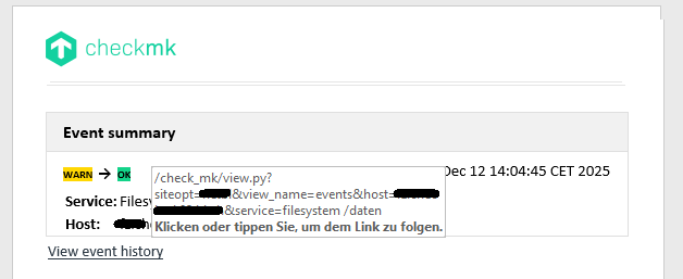

Link "View event history" in E-Mail notification
When i receive an E-Mail notification, there is a link “View event history”, but the link starts with /check_mk/view.py?… , so it is not accessable directly.
How do i make the link starting with “https://[checkmk-hostname]/[site]…
Which version and edition of Checkmk is this?
What are the notification parameters for this notification?
I am sorry for the very late reply. Had so much other things to do at work.
We are using 2.4.0pXY
But i think this was the solution:
