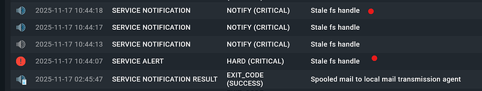

But looking at the history, I can see that the service goes into a hard critical state immediately, ie:
It is interesting that the parameters says “Rule 4”, but I don’t see anything else above it taking precedence or overriding this rule …
Hi Asher,
just to be sure: is your service in a WARN state before it goes into CRIT? Then it won’t go into a soft CRIT but right to a hard CRIT as far as I remember.
Gerd
Ahh - yes! You are right - all of the mounts that are showing this behavior were already in a warning state for a different reason (generally space used). Appreciate the insight here, in my mind the stale fs handle and the space used are logically different (thou for the same resource), so I didn’t put 2 and 2 together. Thanks for the feedback
