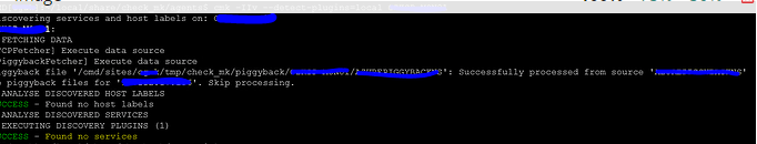

My local powershell script is not being picked up as a local check on the checkmk server:

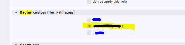

However it is being picked up in the rule ‘Deploy…’
I’ve made the custom folder downwards with full access also.

See my original screenshot, shouldn’t it show up as a service though from that command?

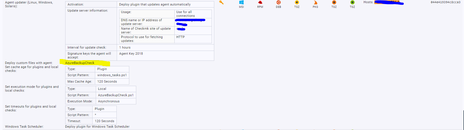

Yes I baked the agent with the ‘Deploy…’ rule and I also manually installed the newly baked agent file.

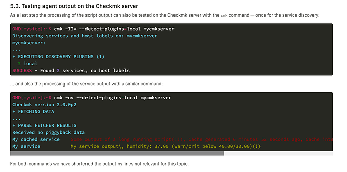

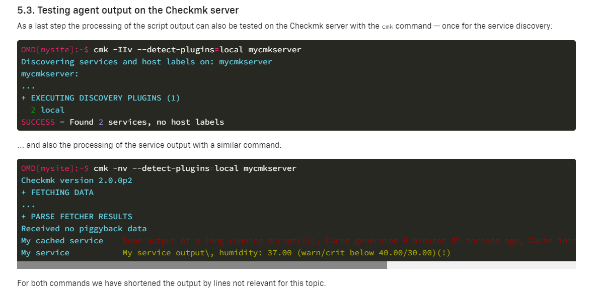

So running this command as per the documentation screenshot the server doesn’t recognise the script as a new service, which I presume is the initial reason why it won’t be pushed out to the server via the agent.
If you search for that Host in the search Filter of the Bakery, do you see the custom Plugin in the Configuration
Yes

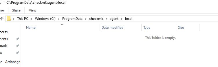

And the Script is not being present in c:\programdata\checkmk\agent\local ?
Is that what the bakery is actually doing just pushing the script to this folder like Group Policy would I didn’t realise that.
But yes it’s not there. Is there a way of clearing the cache of having it re-try this maybe?
