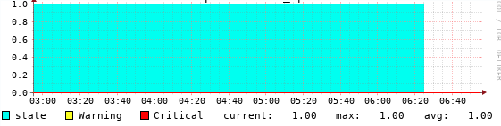

I wanted to connect the graph with the state, some thing like the attached imageScreenshot from 2020-06-15 08-54-48
