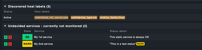

I have been following a Guide to test Local Checks.
However My Local Check is not displayed as a service as it is in the Guide.
Would appreciate any help with this , thanks.

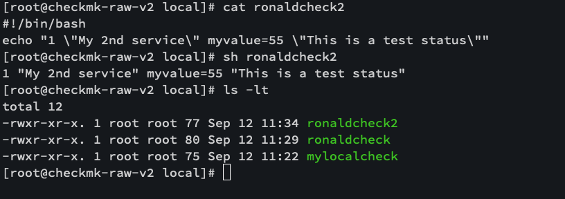

If some other script writes output that should just be concatenated, use the spool directory. In your case, you wrote the output in the script. If you run it with ./mylocalcheck you get an error.
The file in /usr/lib/check_mk_agent/local has to be a shellscript/executable. I don’t see the shebang (#!/bin/bash) in the first line. Can you please add that and try again?
Edit: The output has to be echo’d/cat’d/printf’d/…
What happens when you just execute “./ronaldcheck”?
Thanks to both of you, now its working.
I should have copied both line as in the document.
Thanks a lot

I have looked in the guide regarding showing the values.
However I think my value is not being displayed.
Performance data/graphs are not shown in the “Edit services” view. After “Accept all” and waiting for at least 2 check intervals the graphs should be generated.
If i remember correctly, metrics are only shown if you use the P state. See chapter 3.1.
