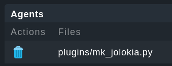

I’m still having some trouble, but making progress. I’m trying to make a modified version of the jolokia plugin that comes with Checkmk, because I need to be able to add some additional headers to the requests.
Modifying the agent plugin works fine. I copied the original to local/share/check_mk/agents/plugins which I have linked to a Git repo. It’s detected fine, and when I build agent packages, it includes my modified version.

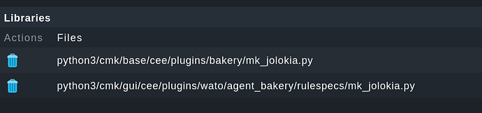

Next I would like to modify the rulespec form that defines what is to be put into the config file of the agent plugin. So I copied the original file:
/omd/versions/default/lib/python3/cmk/gui/cee/plugins/wato/agent_bakery/rulespecs/mk_jolokia.py
to:
~/local/lib/python3/cmk/gui/cee/plugins/wato/agent_bakery/rulespecs/mk_jolokia.py
I tried making cmk/ a link to my Git reposotory, but it does not seem to like that, the file does not show up in the unpackaged files list unter Extension Packages then.
I then removed the cmk link again and placed my modified file at the location without using any links, and now the file shows up under unpackaged files:
Is this the right location to put the rulespec file? It does not seem to be, my modification in that file does not show in the agent rules form, although I did an omd restart.
Could you give me hint where to place these files? I need to modify the agent plugin and the form, to give the agent plugin some addional config parameters and change it’s behaviour a little.
