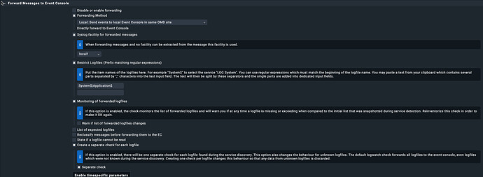

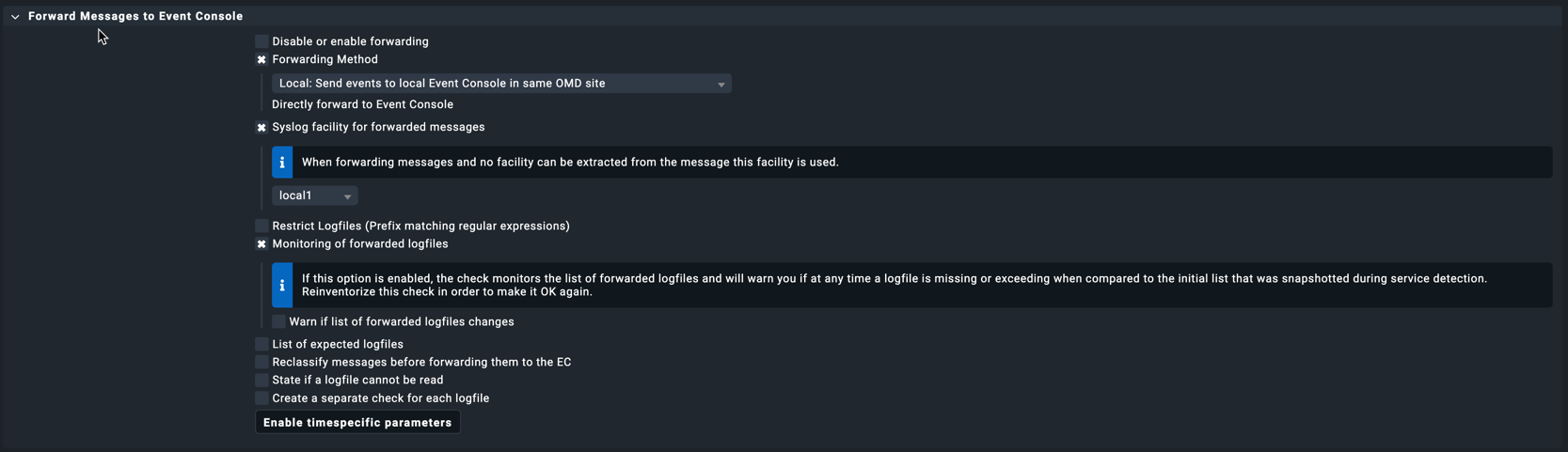

For the “Logwatch Event Console Forwarding Rule” you can specify different filters for which log files will be forwarded to the Event Console. See below:
The filter that you will want is the “Restrict Logfiles (Prefix matching regular expressions)”. This will be a regex to include/exclude the log files.
Another option is to set the “Create a separate check for each logfile” option as well which will treat each log being monitored as a service.
I have found it useful to configure the “Check event state in Event Console” rule as well. This will create a service on each host to monitor events for that host. Its quite handy to be able to right click on this service and view Event Console events filtered by the host selected.

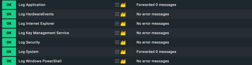

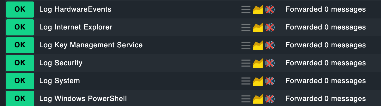

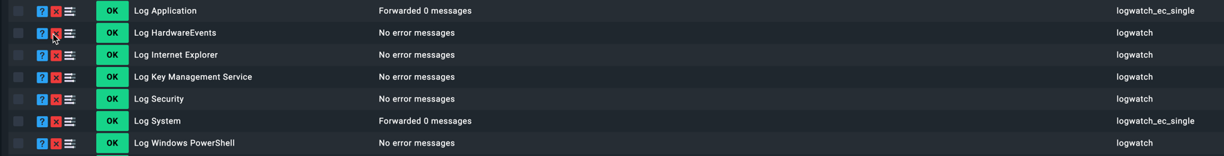

It was more about the question, that we cant seperate the to be forwarded logs and those which has to stay untouched. But once configured the “forwarding”, checkmk will forward everything, regardless what we set in the forwarding rule. So also “Log Security”.
In the screenshot you can see, that now all Logs switched to that mode.
The settings “list of expected” or “restrict” seems not working.

Hi David,

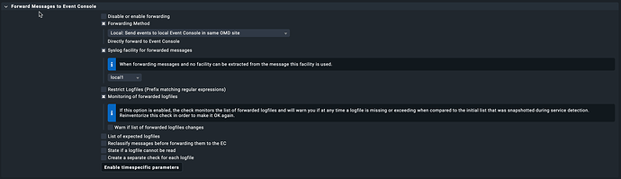

The rule config below has the “Log Security” and “Log Application” going to the event console (the option “Restrict Logfiles (Prefix matching regular expressions)” is set to the suffix of logs we want to forward) - the rest just being monitored via logwatch as normal:

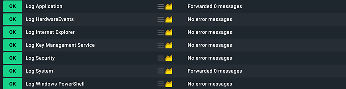

In service discovery note that the logwatch plugin is being used for the non-forwarded logs and the logwatch_ec_single is being used for the forwarded logs:
After service discovery and applying the changes the status view should show the correct forwarding:
I tried testing with a negative match in the regex but it did not work - looks like it must have positive matches only.
