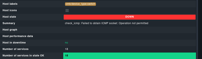

check_icmp: Failed to obtain ICMP socket: Operation not permitted
This is shown for all hosts. Adding them and doing the Ping test works, but the regular
background check fails.

I can also add hosts and services are discovered. They are however shown as down. The connection test shows working Ping
this a switch I monitored via snmp.
