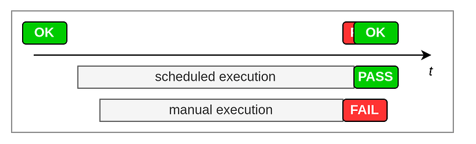

Unlike Checkmk-internal active checks, the RobotFramework-based tests tend to have a longer runtime.
This means that there is a high probability that you might run a test manually while a regularly scheduled test is still running. The results will arrive at Checkmk in short time then.
In the worst case, the failure (CRIT) of your manual execution is immediately overwritten by a PASS (OK) of a test that has been running for a longer period of time.
Even if this is certainly not desired (you would like to see the result of your manual execution, don’t you?), this behaviour is correct.
If we try to influence this inherent behaviour of Checkmk, we open a can of worms… :worm: :wink:
