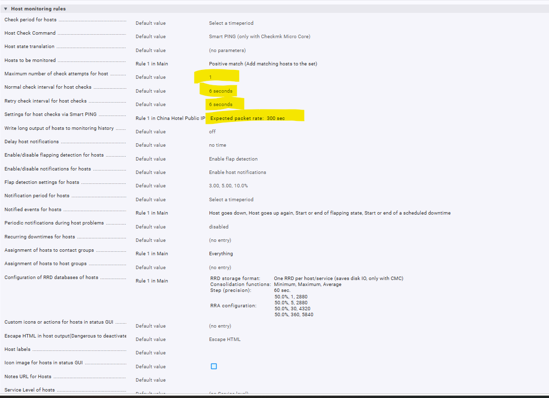

– I don’t see this one packet in 15 second setting, I only see the normal check interval for host check is 6 sec, and retry check interval host host checks is 6 seconds. Please check and advise if those setting need to be amended .

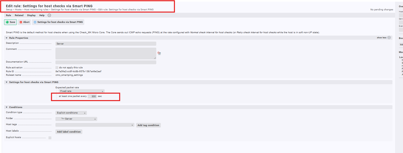

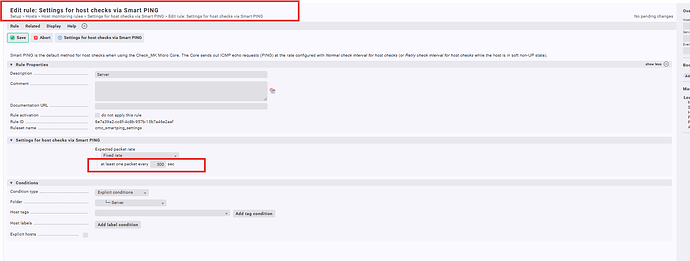

Alternatively, to make it simple to configure and understand , I would set the maximum number check attempt for service to 6 (1 check in every minute) , and leave the smart ping configuration to 300s , so the host will reach hard state in 300s (5 mins) , and service will reach hard state in 6 min, is it ok ?

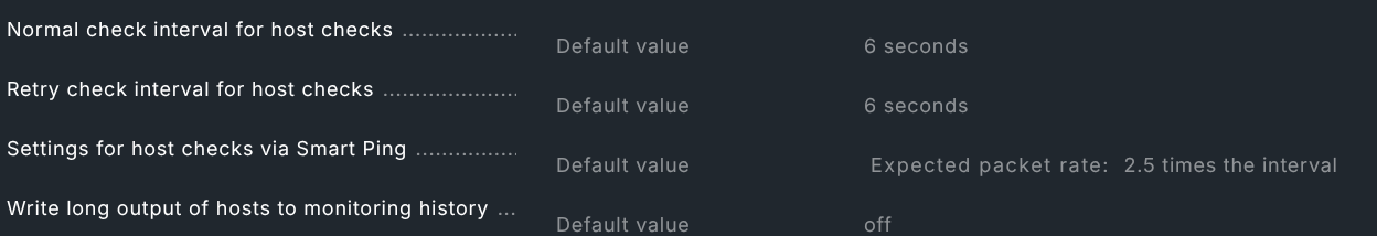

You don’t see it as you have created a rule that set this default value to 300 seconds.
This is how it looks without a rule.
There you see 2.5 times the interval → interval = 6 seconds → 2.5 * 6s = 15 seconds

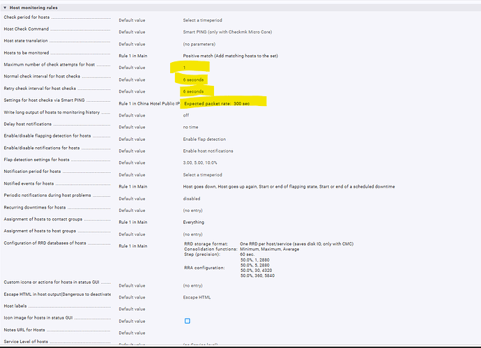

– sorry what do you mean "on the first failure to go to hard state ", which config would make this happen ?
The number of check attempts for host checks. The default setting is 1 and this means at the first error your host state will enter the hard failure state and sent a notification.
This i described in my previous post.
but i have been using this default number of check attempt for host check setting as 1 and the smart ping configuration to 300s since day one, which works ok, the notification is sent out after 300s rather than send out when first check attempt fails.
