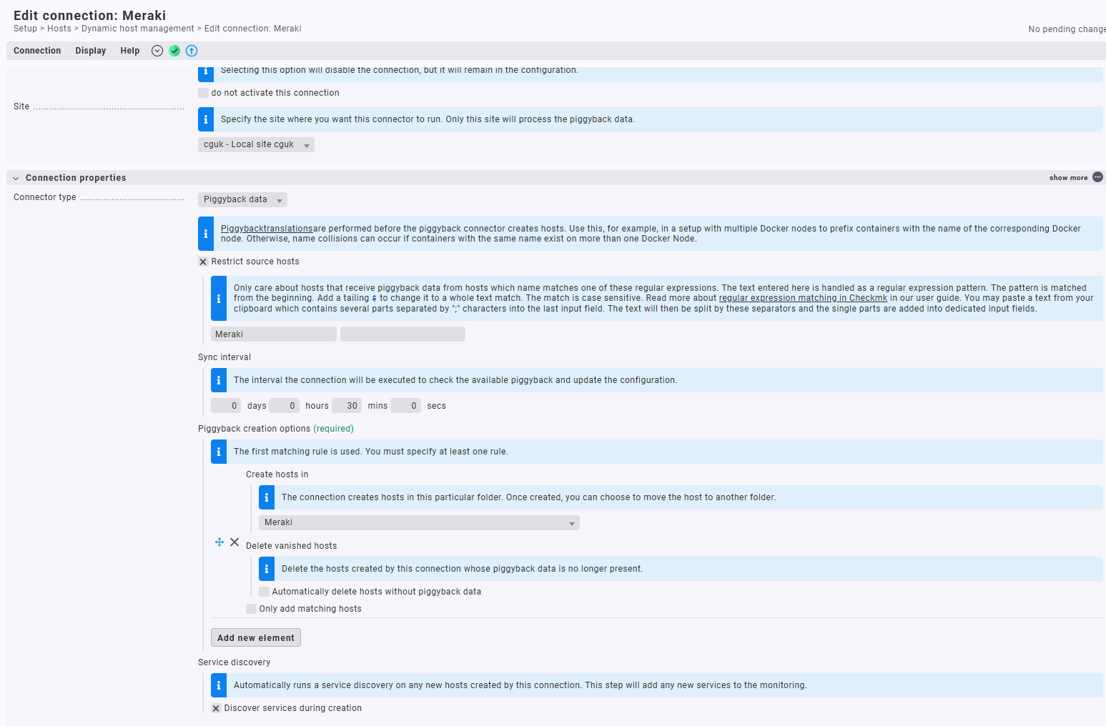

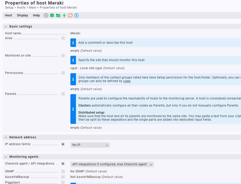

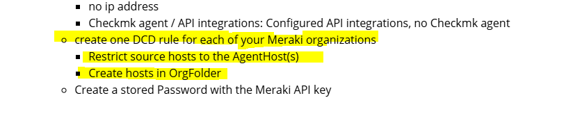

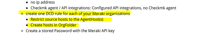

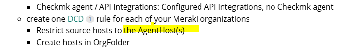

What does 'restrict source host to the AgentHost(s) mean here?
Also I already have all the hosts from Meraki in my monitoring system, I’m interested in the licensing and health status.

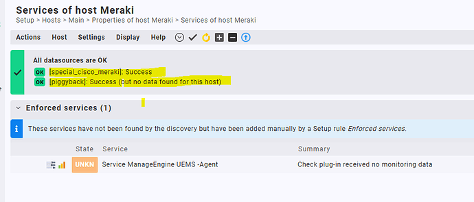

I give it a go following those instructions and I downloaded and enabled the MKP from exchange Cisco Meraki special agent - Checkmk Exchange

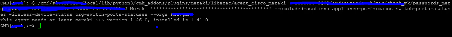

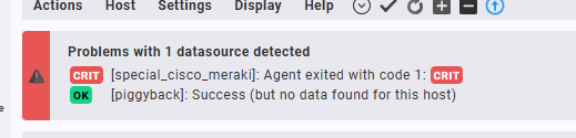

I’m getting this error on my agent host
My DCD has been setup like this:

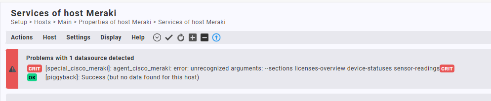

So I tried running the from the command and got this:

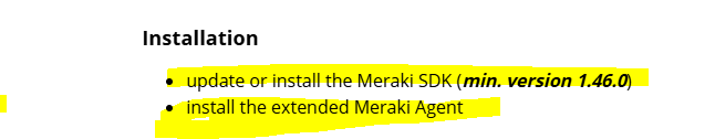

So the next question is how do I update or install the Meraki SDK (min. version 1.46.0)
This is different than the Meraki SDK version 1.46.0 that needs to be installed?
I have updated the HowTo a bit, this includes now links to the DCD documentation, to the latest Meraki agent and to the SDK.

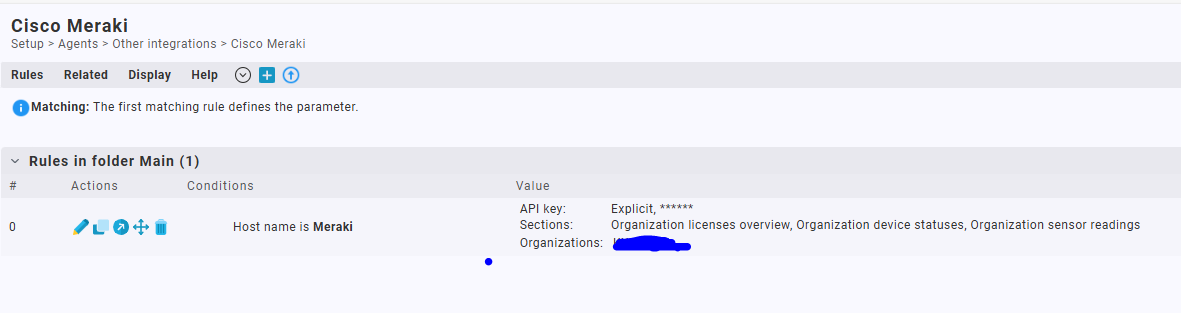

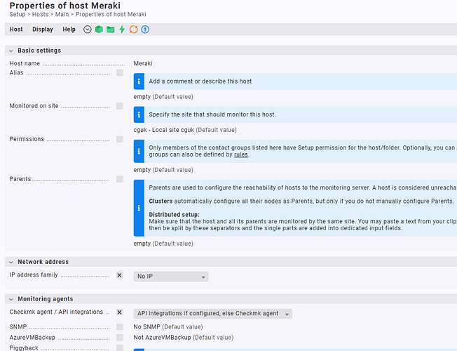

Thanks, can I just check this part
This is restricting the host to the host you’ve created, in my example it’s this
and this is the rule restricted to

What’s the instructions to install the ’ * install the extended Meraki Agent (latest version from thl-cmk.hopto.org)'?
This is confusing to me the difference between the MKP, which is the extension that I already have installed/enabled and the Meraki extended special agent?
yes, this is to make shure the DCD rule is only for this Host
to use the extended Meraki Agent you need to install two packages
  • The Meraki SDK MKP (here you can also use the SDK from the Meraki Github page)
  • The extended Special agent MKP
    • you can use the version from the Exchange
    • the version from my Gitlab
I would recommend using the version from my Gitlab, as this is allways the latest version. On the Exchange I update this only from time to time.

The SDK is a collection of python code from Meraki, that the special agent needs to run. So to use the extended agent you nedd to install both MKPs. For the SDK you can of coure also fetch the latest fersion from Merakis Github page.
look at the forum post I have lnked above (Topic Installation) or of course directly from miy Gitlab site CheckMK / Cisco / Meraki / Cisco Meraki special agent · GitLab → Topic Download.
