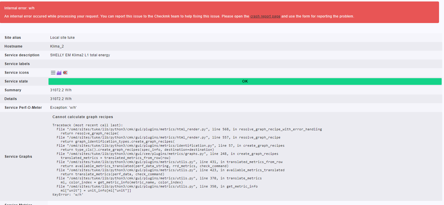

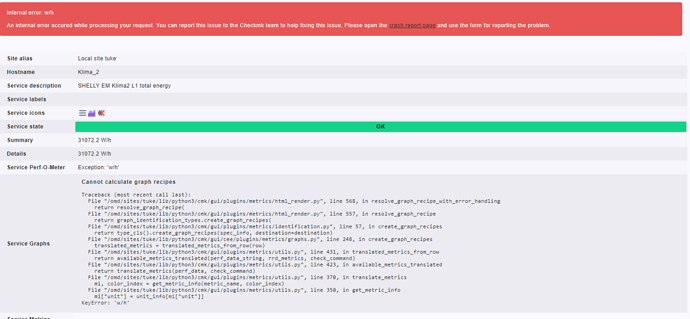

I have slight problem, i am using shelly3EM energy meter. I am gathering data for voltage,curent and total energy consumption using this check : Checkmk Exchange. When i tried to set correct unit for total consuption in graph i get this error. it is possible to add this unit and if yes where i can?
I had a look in unit.py, there is no unit “w/h”. I think you should use “wh” instead.
Regards,
Christian
Thank you very much, it worked as i wanted :slight_smile:.
