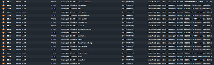

The Microsoft Exchange Services have been intermittently flapping for a few days now - it worked as normal before that though. Looking into the history, it seems like the plugin is crashing:
It seems like the issue is that WMI timeouts keep happening, even with the WMI timeout set to 12 seconds (which is the maximum) in WATO for this host.
