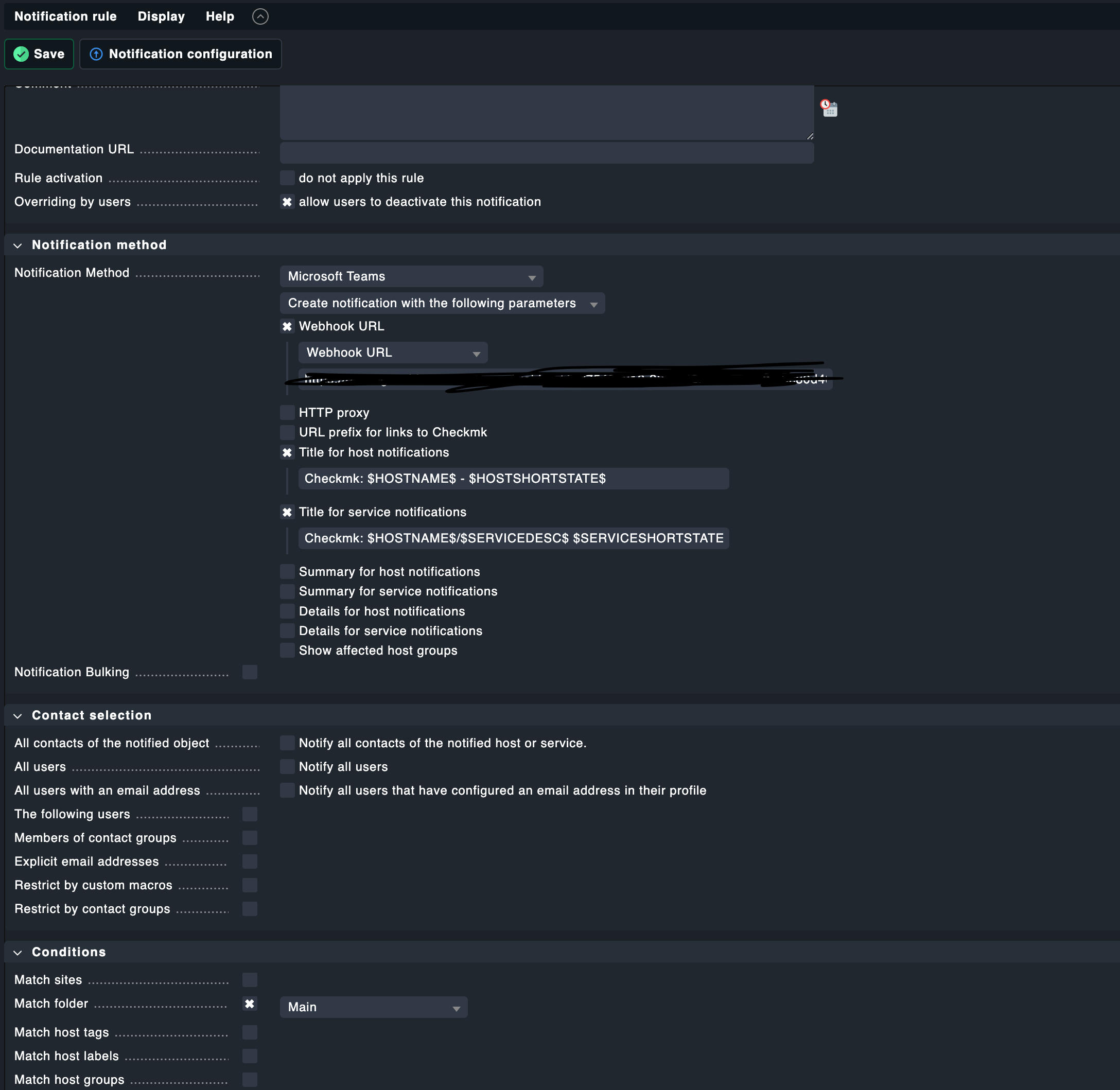

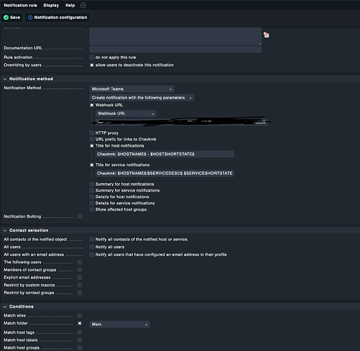

Our configuration for the notification is pretty simple:
Setting Match only during time period is 24x7.

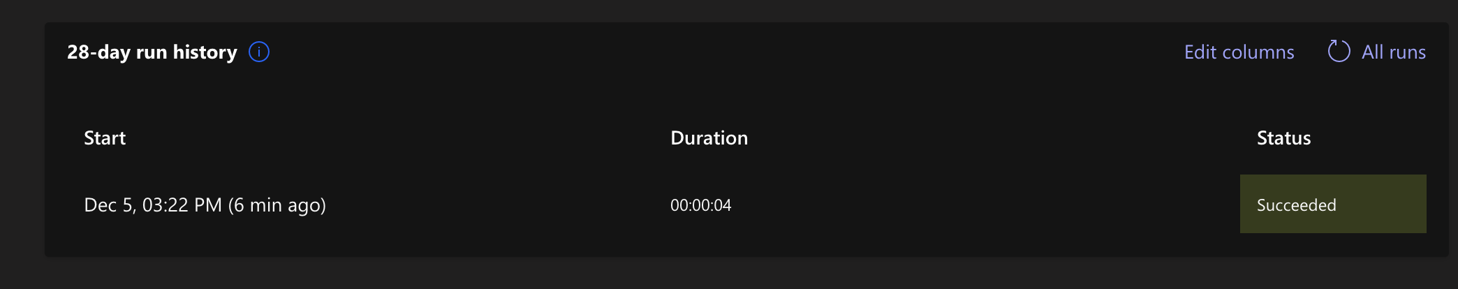

So i configured a new workflow to a public channel (and followed this kb article https://checkmk.atlassian.net/wiki/spaces/KB/pages/151158785/Microsoft+Teams+Use+workflows+instead+of+connectors#MicrosoftTeams:Useworkflowsinsteadofconnectors-PowerAutomate )
I tried the script described in the article and it worked.
So far so good!

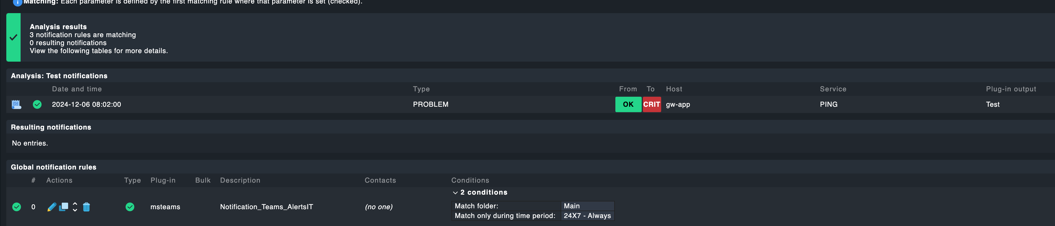

Unfortunately when i do a fake check in checkMK, nothing happens… not even a failure in workflows or anything.

Have you double checked if your rule even matches and did you you choose anything in the “Contact selection” ?
If you follow this then you can analyse the notification by replaying it again and again.
Hi @chauhan_sudhir
I just took another look and double checked the settings.
In contact selection i activated “notify all users”.
The test notification also shows that everything is matching:
I already put several hours in troubleshooting with this problem but maybe i am still missing something.
We did no chances at all with this rule since we first did the config. It worked all the time and just stopped working a few weeks ago.
All i did is changing the URL to the workflow URL connected to our channel (last comment) but it won’t work…
Let me know if you have more ideas to double check. Like i said, maybe i am missing something totally obvious.

  • Could you remove all the coditions i.e. Timeperiod = 24*7 and Folder = Main and try again?
  • Are there any local custom extensions related to msteams under $OMD_ROOT/local folder ?
  • Also, please go to the command line and set a tail on ~/var/log/notify.log as site user and see if you see any errors related to msteams?
OMD[mysite]:~$ tail -f ~/var/log/notify.log
