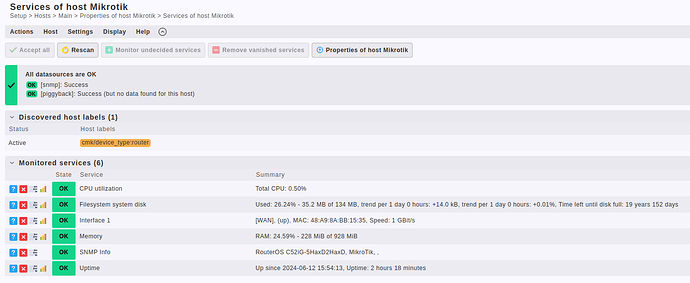

Now, I’m stuck with mkp packages… I’ve managed to install and activate a package for a Mikrotik router. After this point, I don’t know what to do, I’ve deleted and added again the router, but still it monitors the same data as before:
Any idea about how to proceed?
Thank you very much!!
Kind regards.

Hello!!
Yes, I did a re-discover, nothing new appears:
Thank you very much and kind regards!! :smiley:

Looks like, that the OID which is detected not the same as expected by plugin. If you run “cmk --debug -vvII ” and look at the OID. Than you can habe a look in the plugin.
RG, Christian
Hello!!
This is the output of the command cmk --debug -vvII :

I don’t know if there is something wrong…
Best regards!! :smiley:
The installed package is a special agent. You need to configure your device to use this special agent.
Inside the host configuration select specially agent and no checkmk agent instead of no agent at all.
Then you need to assign the special agent inside the “other integration” section.

As i wrote the answer from my phone i had not the correct wording.
“Configured API integrations, no CheckMK agent” is the right one.
Here you should then find the Mikrotik agent and can configure it.
Ok, I understand now, thank you very much!! :grinning:
After choosing the MikroTik RouterOS agent:
I configure a new rule:
But still doesn’t work, I use the credentials for access to the management router console, but I’m not sure if they are the correct ones…
Kind regards!! :grinning:
I don’t think that the port is the right one…
