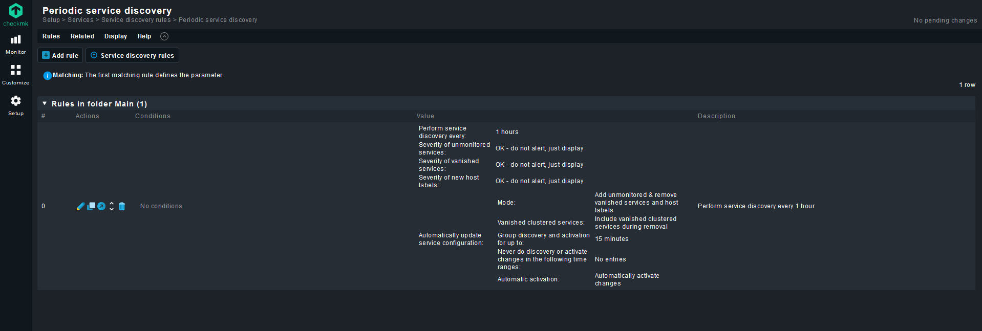

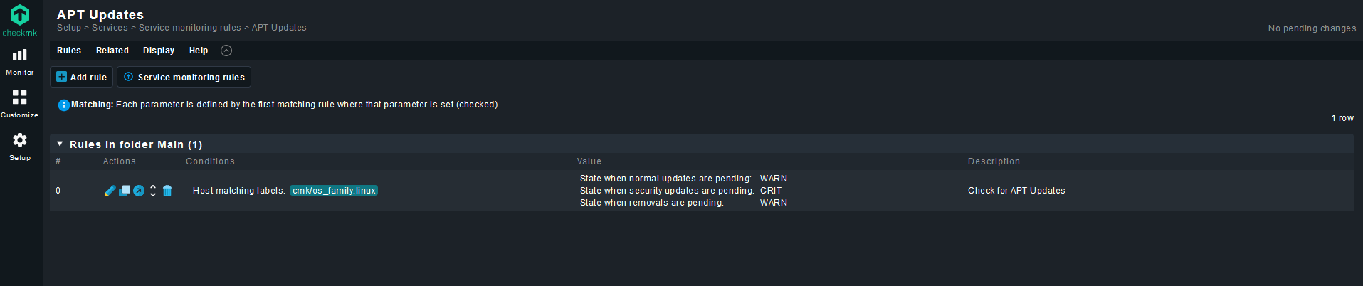

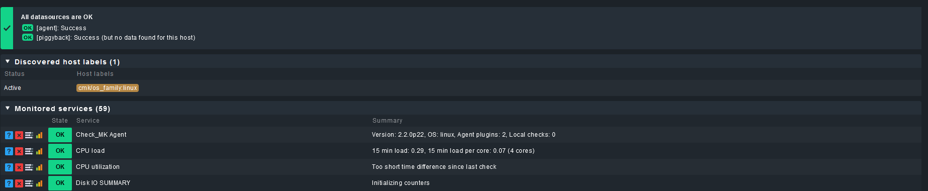

I’m not sure of what files would show the appropriate service configuration for the mk_apt plug-in to work, hopefully these screenshots are sufficient:
Service discovery rules:
Periodic service discovery:
APT Updates:
Host label:

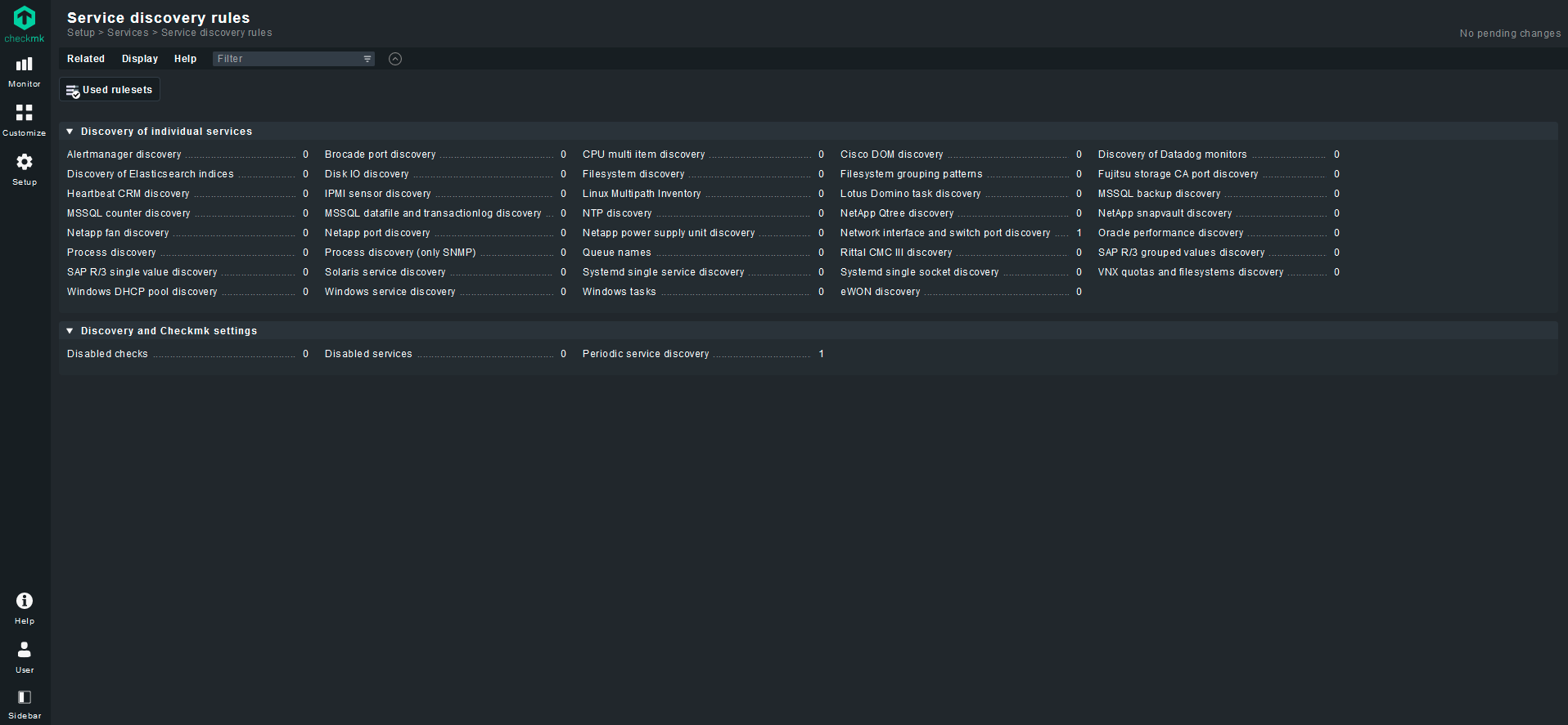

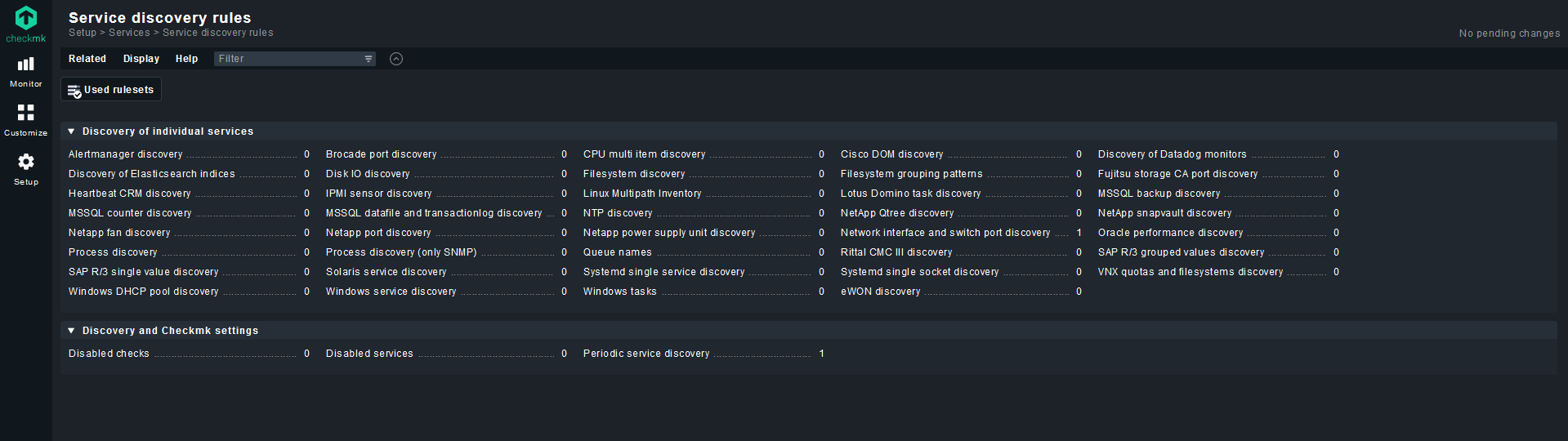

You are looking in the wrong place. Search the Setup menu for “disabled”.
Ok, 2 hits are returned by the suggested query…
2024-06-03_1
…and they both appear to be within the “Service discovery rules” :person_shrugging: :
…neither seem to contain any rules defined to disable Checks or Services though.
Those were the rulesets I was referring to. But as they are empty, they have no effect.
