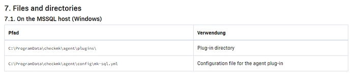

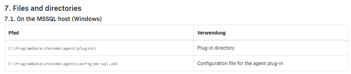

When launching the mk-sql.exe executable from the programdata…plugins directory, I get the following error.
Stop on error: `The config file ".\\mk-sql.yml" doesn't exist`
I assume I need to create this file, but I can’t find any reference to it, so I have no idea how to fill it up. I wanted to use it instead of the original mssql.vbs since that one never worked on our SQL 2017 servers (it works on freshly installed ones) and I never figured out why.
This is a different VM where I’m testing the new plug-in. TCP/IP is enabled on the server.

So just wondering how to use the new plugin, especially the configuration file, what to do with that.
