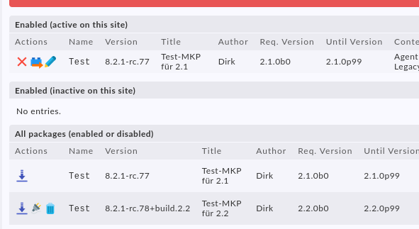

Let me take this opportunity to ask you this (very seriously, not rethorically!): Would you prefer if Checkmk adhered to the version fields unconditionally, even if you could not edit such an MKP anymore at all in a not supported site?
Clear no - from my point of view a warning message that you enabled an old MKP would be the best solution.
Result:
You can edit the package but you also see that old MKPs are enabled with the warning.
