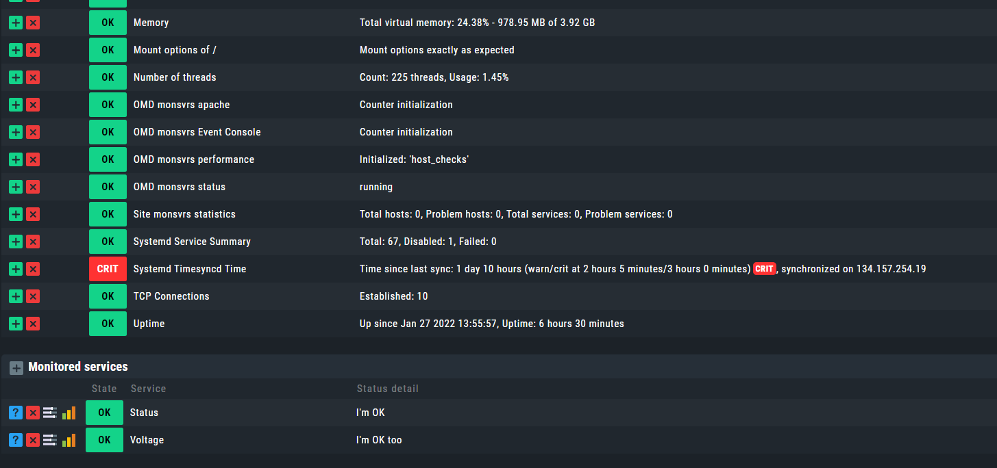

I understand more theoretically now, you help me a lot.
Ok now I finally find the good syntax for the script and I had a result :
My services appears correctly but with the others services of the host like you said.
There is the script in question :
#!/bin/sh
echo "<<<local>>>"
echo "0 Status - I'm OK"
echo "0 Voltage - I'm OK too"
In settings host, I had to specify 127.0.0.1 as IP adress, and enable the agent not disabling it.
Now I will try the piggyback method :wink:

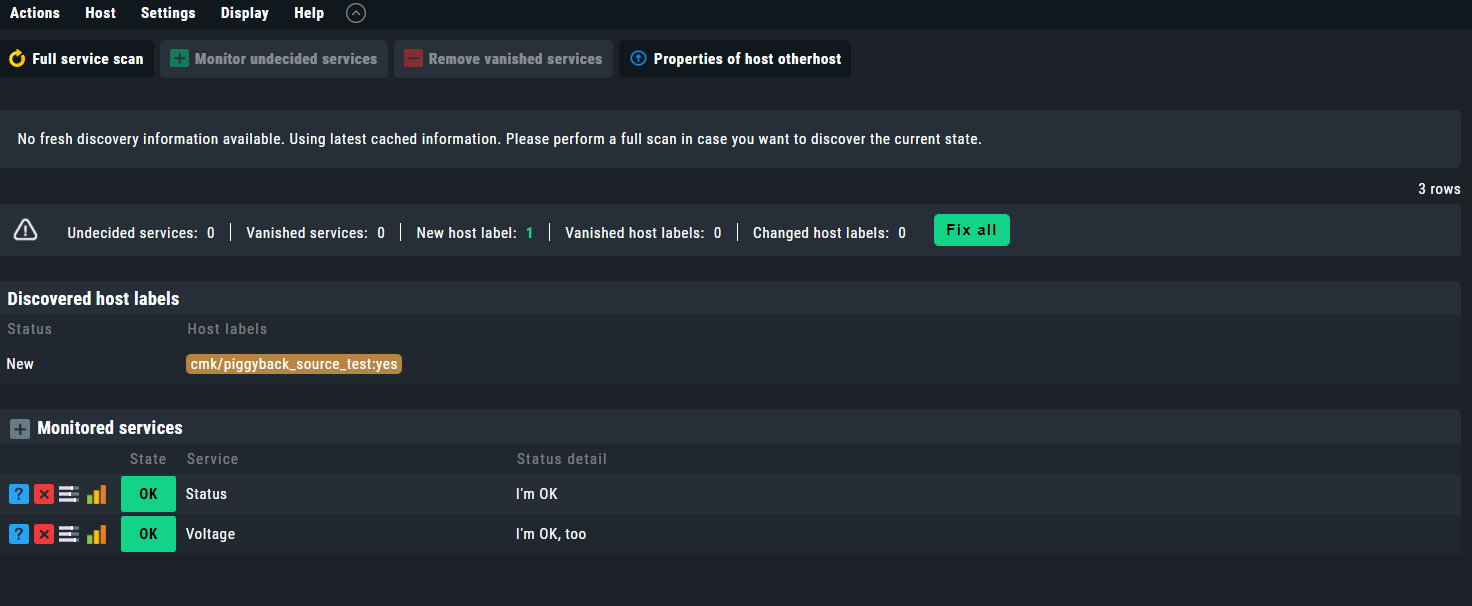

So if I use the piggyback method, I also have to specify an IP adress, and enable API/agent ?
If you want to use/test the piggyback method, you will have two hosts in “Setup” in the end:
  • Your main host, with default settings (i.e. agent enabled, IP address is set) as it is now.
  • Your otherhost which is piggybacked, has no agent and no IP, as in my example.

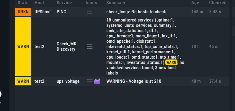

I modified the script in question : #!/bin/bash
#!/bin/bash
#echo "<<<<UPShost>>>>"
#echo "<<<local>>>"
OUTPUT=$(cat /home/user1/5.txt)
voltage=$(grep -e "output.voltage" <<< "${OUTPUT}" | awk -F ': ' '{print $2}' | awk -F '.' '{print $1}')
if [ ${voltage} -gt 200 ]; then
   echo  "1 ups_voltage voltage=${voltage};200;190 WARNING - Voltage is at ${voltage}"
fi
And he’s working well :
I didn’t understood well the metric here :
Does that mean if the voltage is at “190” then it will be CRITIAL instead WARNING ?

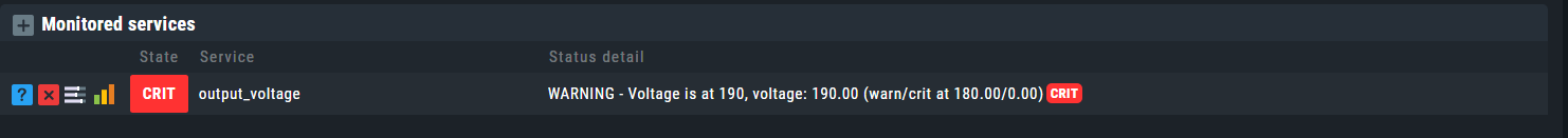

About the metrics, for exemple, the output_voltage :
  • I want it to returns me CRITICAL if the value is lower than 180
  • WARN if the value is between 180 and 195
  • And OK if the value is upper than 195.
From what I’ve read the best option to use is :
3.5. Upper and lower thresholds
There is the syntax :
metricname=value;warn_lower:warn_upper;crit_lower:crit_upper
So my metric should be like this ? :
echo "P output_voltage voltage=${voltage};195:180;180:0 WARNING - Voltage is at ${voltage}"
But if I put the value of “output_voltage” at 190 for exemple it returns me CRIT :
crit_upper=0 and 190 is above 0 :wink:
