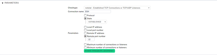

then I have the rule configured as follows
At the agent’s exit. I don’t see anything in the section

It is correct what @martin.schwarza says that happened to me. @ikoening I have run it and if I get a netstat output of all connections. What I do not understand the output that appears in the checkmk
I don’t understand the matching entries found: 0. In the netstat I see that there are three established ssh connections. The question is, as long as there are connections, will it show me the output of the image? Doesn’t it count?

Are you trying to monitor the SSH connections to that host, so how many users are logged in on that machine, or do you want to monitor SSH connections from that host, so how many users are connection to a machine via SSH from that host?
Because in the screenshot from above you have specified the remote port to be port 22, so that would monitor outgoing SSH connections from that host to other hosts.
If you want to monitor SSH connections to that host you have to input port 22 for “Local port number” and not “Remote port number”
You are right. I want to know many users are logged in on that machine, Sorry for not realizing.Thank you very much
