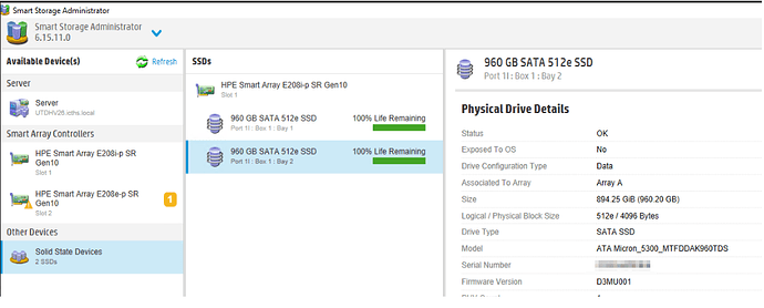

Hi all,
Does anybody know how to monitor SSD life remaining on a HPE server within check mk?
You can see the status within “Smart Storage Administrator” software.
Kind regards, Jeroen.
