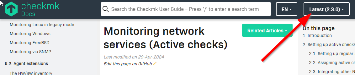

Be careful: A lot has changed here with the release of Checkmk 2.3. So when looking at the documentation, make sure to select your version for the correct instructions.
Take a look here:

Hi @elkhedewy
If you select version 1.6 in the docs article I linked, you will get to the article for your version. You can follow that. The first example is for Check_http, which is the check you are looking for.

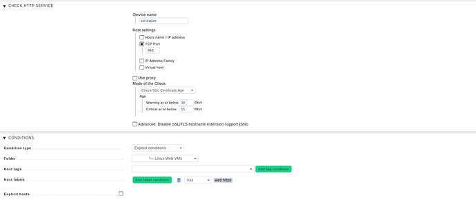

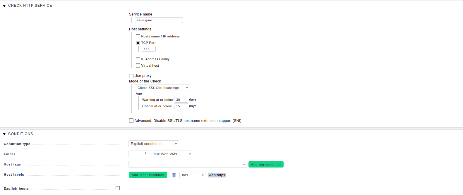

Many Thanks you made my day. But found some errors if you can help me.
Here is the rule i used

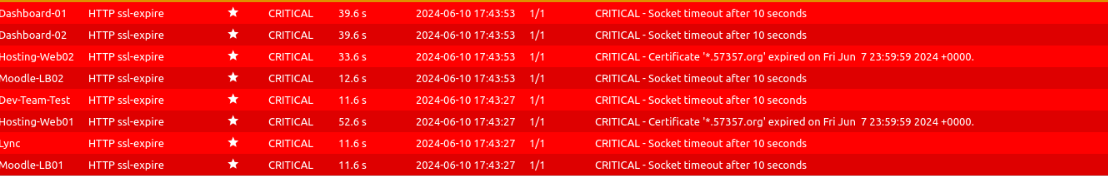

And when the check is active i noticed that it give some errors on many Vms
Example for the error:
CRITICAL - Socket timeout after 10 seconds

But why on many vms it give the below error
I’m using the same check and the same ssl wild certificate on other VMs and its working fine.
Why it give the errors on screen shot on those VMs?
