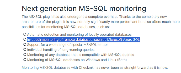

I think this is possible with the new mssql check in checkmk 2.3
Is there a link which describes this? How can it monitor if it can’t get the agent onto the instance?
Any further info I do see this. Does this mean a SQL managed instance in Azure can be monitored if there is no VM.
Although this would rely on us getting our Subscriptions working which I have a support ticket open for which is an essential part of our requirements.
I think the data is being fetched via SQL commands remotely and no checkmk agent in necessary on the the db server.

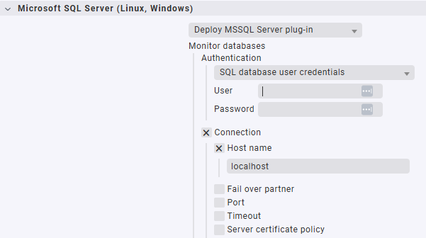

The monitoring should be done by a device with Checkmk Agent + SQL Plugin. In Agent Bakery you can define the parameters:
You could deploy the agent on Checkmk Server and use it to query your remote instance, at least theoretically.
Yes in ‘theory’, does it work though? There’s no documentation around this.
What would the hostname be, the Azure SQL database IP address?
Yes, but ideally you will provide the DNS in use for that connection.
Ideally, you just need “hostname” , “username” and “password” . That’s it. You will be connecting the remote Azure SQL service. There is nothing else attached to it. For example, below is more than enough:
/usr/lib/check_mk_agent/plugins# cat /etc/check_mk/mk-sql.yml
mssql:
  main:
    authentication:
      username: username
      password: password
      type: sql_server
    connection:
      hostname: myazuredatabaseserver.database.windows.net
      port: 1433
      trust_server_certificate: true
Before that, try to do a basic telnet/nc to check whether the port is reachable or not.
