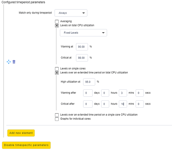

HI all,
my question is related to cpu load monitoring. How do i set the warning alarm to send only when the load is longer than 3 minutes and the critical 10 minutes?
I did this setup but notification still arrives as soon as load reaches warning and critical values.

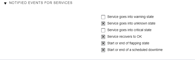

Hi do you ajust also the rule:
Notified events for services
or does an other rule matches the Host or Service ?
also a option is the rule
Delay service notifications
Greets Bernd
Thanks for answer.
I set up rule Notified events for services. is it well adjusted?
after this setup, all the same happens.

remove the option “Levels on total CPU utilization’”.
Karl
if I remove this option, the tool sets its default warning and critical values to 101%.

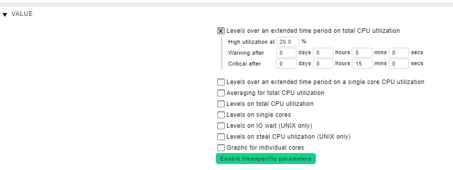

as @BH2005 mentioned you can use the rule “Delay service notifications”.
Karl
I checked this rule in one of my systems and it is working without problem.
After 5 minutes and more then 20% cpu usage i get an warning and also after 15 minutes the critical.
No other values are defined. In your system the 101% comes from another rule and is merged for this host. The 101% rules needs an exclude for hosts where you want to get the usage over time.
I can confirme @andreas-doehler
Thanks all for answers.
I removed option “Levels on total CPU utilization”. I set the CPU load high value to 95% and the tool sends a warning alert to 95% and higher if that value is held for 3 minutes, and if held for 10 minutes it sends a critical alert. It’s just like you said.
