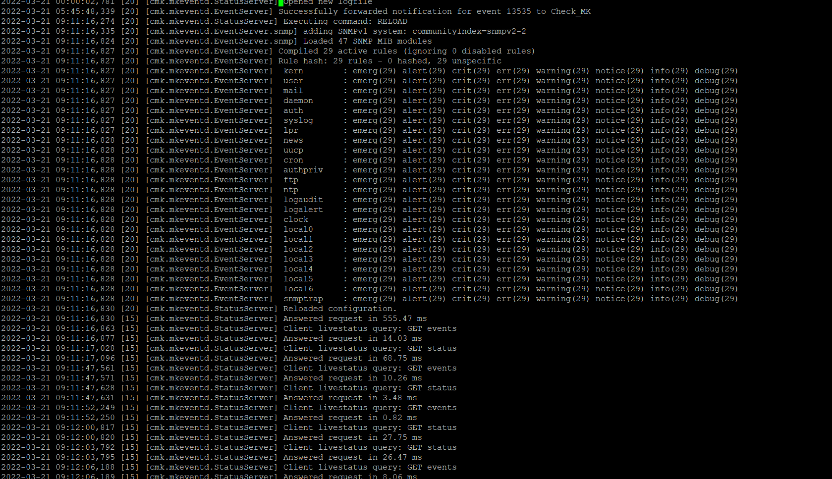

I did as you said and the image below shows what is in the mkeventd.log.
I really do not understand what to do with the information here.
Hi, normally you wil see here th incomming traps on mkeventd. in your picture, no traps are received after restart. So, please check if mkeventd is able to receive traps. With a netstat you have to look if port 162 is bound to mkeventd.
