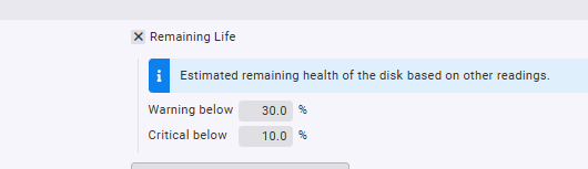

There seems to only be one reading for ‘Remaining Life’ for the Windows monitoring based on ‘other readings’:
Yes but the windows evenlog in the windows agent will by default notify you of errors seen there, so any detected corruption should allready appear when using the checkmk windows agent…
