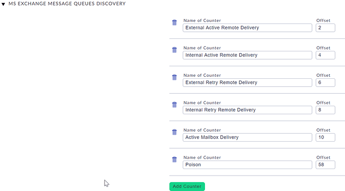

I checked with your data an created the following rule inside MS Exchange Message Queues Discovery
Then the discovery shows all the defined queues without error.
In your case the problem is inside the rule MS Exchange Message Queues. There is some offset defined in your system. Remove the offset and check if it is working then.

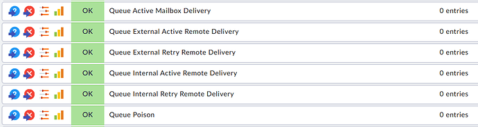

I moved the file so it does not mess with my checks. I also created the same rule as you did, there are no other rules of the type “MS Exchange Message Queues Discovery” defined:
After doing a full discovery the checks stay the same, but the parameters no longer show the “Invalid check parameter”-error (I mentioned this in my first post). But the offset stays the same and other no other queues are found:
Funny thing is, this happens only on one of my systems. I have other Checkmk Servers in other locations where the configuration works just fine.
Are there maybe some other files messing with my checks? Any guesses?
