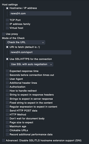

I’ve been fiddling around with monitoring a specific web page and struggling a little bit, perhaps the community might be able to assist me.
As an example.
I’ve been trying to set up a monitor for the following URL: www.news24 .com/sport
In Check_HTTP_Service i have the following configured:

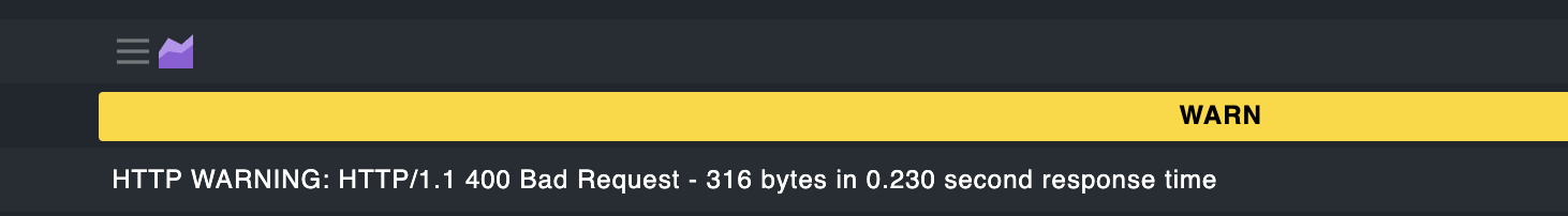

However, I get the below WARN on the actual test:
Am I missing something or is this type of check not designed for what I’m trying to achieve?
Regards
Ro

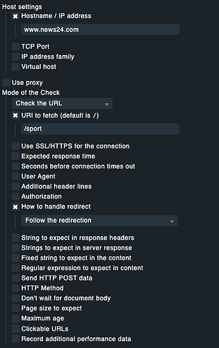

  1. You can’t have the domain name in the URI unless the URI is news24.com/news24.com/sport
  2. If you use SSL your server needs to have all the certs. use curl to check if you can access the site first (this is a good practice)
    3.) The site might have re-directs and if Checkmk is not told to follow them, it won’t. SPORT24 - On top of your game might be re-directed (as an example) to news24.com/sport/index.html
Thanks for the guidance @Anders , appreciated.
I’ve modified the configuration as you’ve suggested:
And unfortunately still failing:
Performing a CURL from the CheckMK Server, it looks like everything works fine (200 OK)

Any further insights would be appreciated :slight_smile:
Found the solution in another thread :slight_smile:
Thanks @Josef
Yes,
Just so anyone else finding this post - The solution is to add the Virtual Host as well. This is a bit confusing (actually most text in English here is confusing for someone who have worked with the web for over 20 years…)
This, i think just means you should send a HTTP/1.1 request where you include the domain name in the request (This was added long time ago in browsers, curl etc that allows the web host to have mutilple domain-namnes on the same IP adress, that was not possible with HTTP/1.0)
And with HTTPS you have the same feature, called SNI. Most CDNs will check both to see if they mach, if not they might refuse the connection like we saw here :frowning:
