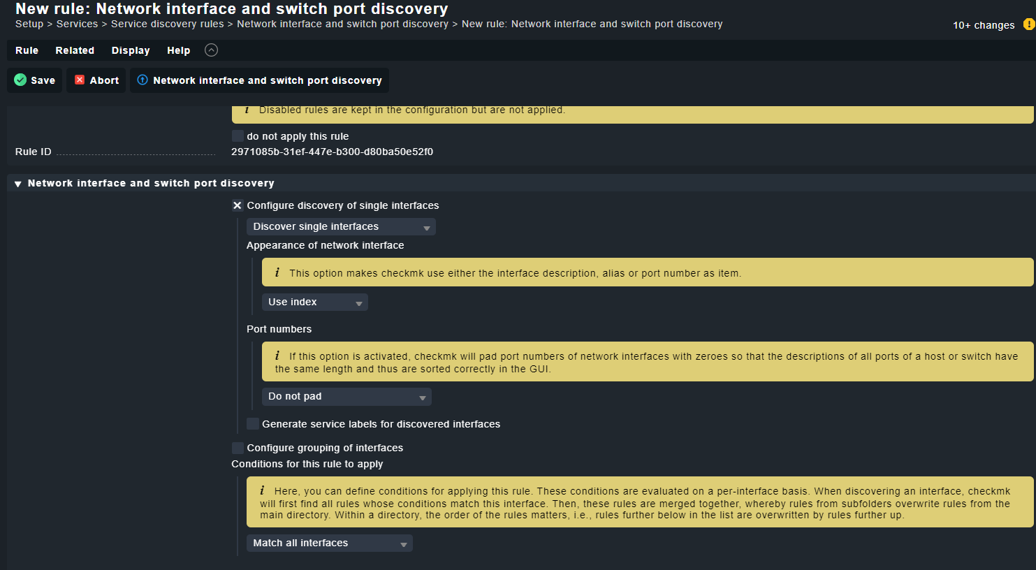

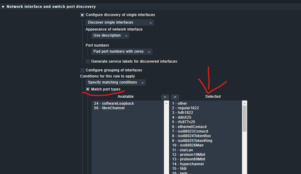

May try rule “Network interface and switch port discovery” and enable all Interface Types and re-discover the device. If the tunnel is an interface in the standard MIB it should appear as a normal interface. At least on Checkpoint thats the case.
HI MIke,
You mean like this?

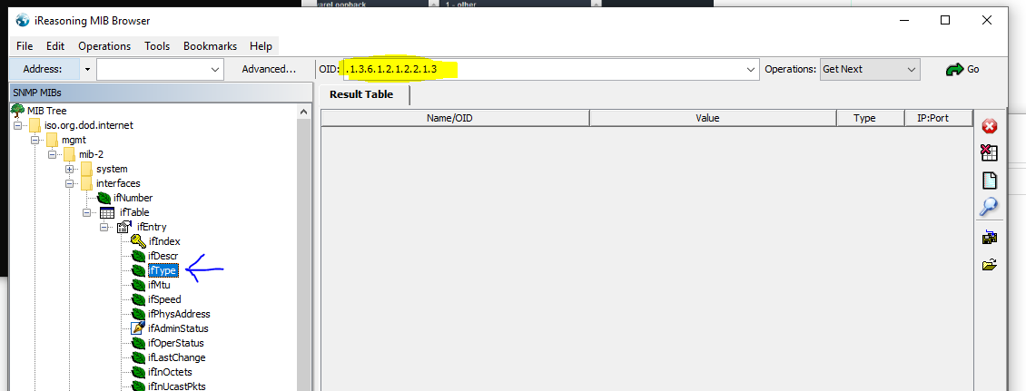

Not yet but you can find out by snmp query:
10.0-957.21.3cpx86_64
