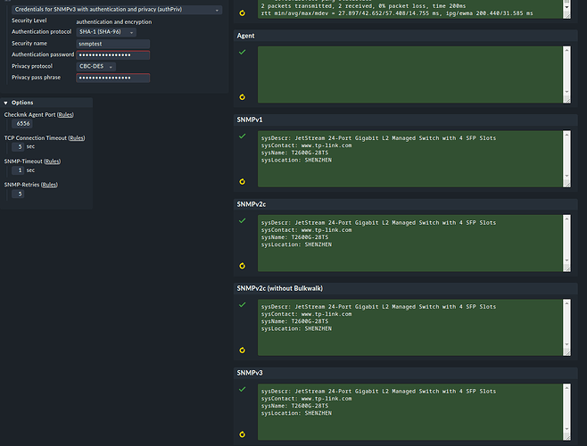

Description: I am currently facing an issue with the implementation of SNMPv3 on my system. Despite attempting various password lengths and combinations, as suggested by the error message, I have been unable to establish a successful connection. I have experimented with password lengths ranging from less than 8 characters to 16 characters, including variations in case sensitivity, and the inclusion of special characters and numbers.
Despite these efforts, the connection consistently returns the same error, as depicted in the attached image. The error message provides no specific information on the nature of the issue, making it challenging to identify the root cause of the problem.
In further debugging of the SNMPv3 connection problem I noticed some strange behavior. When I configure credentials using Host properties and run connection tests, I always get an error message as shown in the previous image. However, if I manually re-enter the same credentials during the connection test, the connection succeeds (see next image).
This discrepancy raises concerns because credentials, when issued through the Host property, do not appear to provide accurate connection checks. I want to confirm that there is no typo here, as I have validated the inputs with the command “cmk --debug -vvn”, which confirmed that the credentials used by Check_MK are the same as the credentials I entered manually.
Given this evidence, it strongly suggests that a potential software-related issue rather than a user bug would cause issues. I request help in investigating and maintaining this behavior to ensure consistent and reliable SNMPv3 connection.
Here is the other image since I am currently unable to include two images in one post…
