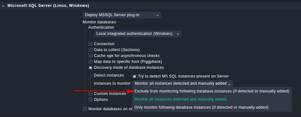

Maybe you can use the labels at the host level to apply the bakery configuration accordingly? For the not needed sections those will be not queried from the secondary node depending on the label
It might also be an idea to set up a cluster object in Checkmk and make the services in question clustered. You can then set the aggregation mode to “best”, so only the best result will be used.

On your recommendation I tried this, but the plugin keeps trying to retrieve data from the secondary replica, which causes a lot of errors on the SQL server and thus clogs the log.
The target database, ‘TestDB’, is participating in an availability group and is currently not accessible for queries. Either data movement is suspended or the availability replica is not enabled for read access. To allow read-only access to this and other databases in the availability group, enable read access to one or more secondary availability replicas in the group. For more information, see the ALTER AVAILABILITY GROUP statement in SQL Server Books Online.
