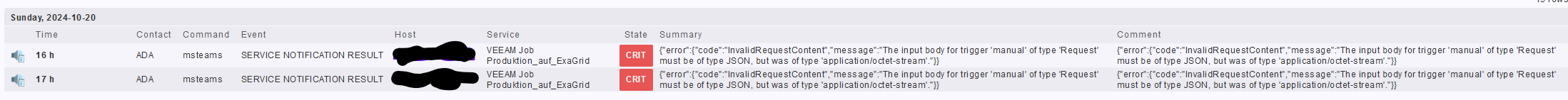

The Messages aren’t leaving the Checkmk! in Monitor–>Failed Notifications I can see them “trying” to get out to reach MS-Teams, but there is an error:
{“error”:{“code”:“InvalidRequestContent”,“message”:“The input body for trigger ‘manual’ of type ‘Request’ must be of type JSON, but was of type ‘application/octet-stream’.”}}

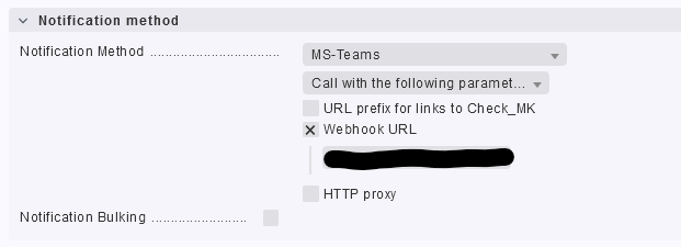

Also, the name of my Notification Method is MS-Teams and not Microsoft Teams as in the KB article suggested. All I can see is:
grafik
There is also no “Fake Check” but “Test Notifications” on our CheckMK Website.

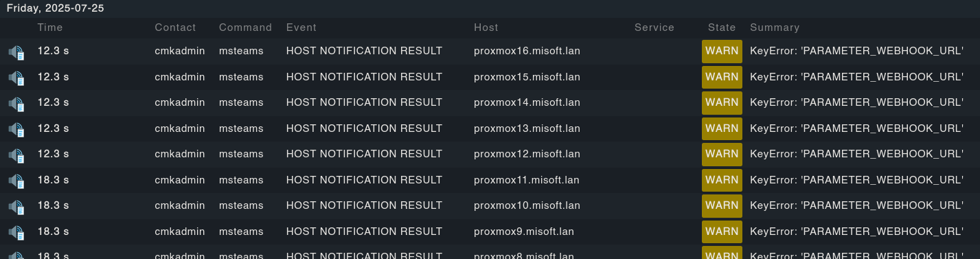

Now, with the build-in Plugin, I can the next error:
KeyError: ‘PARAMETER_WEBHOOK_URL’
Of course, the URL is a MS-Teams-Workflow URL. I’ll test further.
Blockquote
Traceback (most recent call last): – File “/omd/sites/MYSITE/share/check_mk/notifications/msteams”, line 13, in – sys.exit(main()) – ^^^^^^ – File “/omd/sites/MYSITE/lib/python3/cmk/notification_plugins/msteams.py”, line 187, in main – return process_by_status_code(post_request(_msteams_msg), 202) – ^^^^^^^^^^^^^^^^^^^^^^^^^^ – File “/omd/sites/MYSITE/lib/python3/cmk/notification_plugins/utils.py”, line 256, in post_request – url = retrieve_from_passwordstore(context[“PARAMETER_WEBHOOK_URL”]) – ~~~~~~~^^^^^^^^^^^^^^^^^^^^^^^^^ – KeyError: ‘PARAMETER_WEBHOOK_URL’
Anyone an idea why it isnt’t working?
I’ve tried to post an AdaptivCard on server via shell (debian) and it worked very well. Python Requests works great. I still get the error above
“KeyError: ‘PARAMETER_WEBHOOK_URL’”

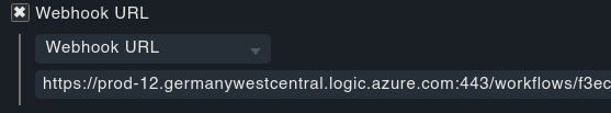

The filed Webhook URL is of course filled with the right url…

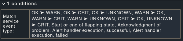

hmm, I am receiving the same error (KeyError: 'PARAMETER_WEBHOOK_URL') after enabling this condition:
the webhook url is set all the time:
The reason why i stumbled across this is that I do not want msteams to get the downtime notifications…

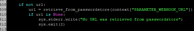

Yes, I got a workaround fix for this. You should act with care due to the fact that, by doing this, you can break something in the process.
Simply explained: you have to look on the server directly for the “PARAMETER_WEBHOOK_URL” (check the comment section in the failed notifications tab, it should be utils.py) and modify this to match exactly the Webhook URL.
before:
grafik
after:
grafik
Hope it helps
Yep, this fixes the problem for me too! Thanks! Would love to see this fixed @robin.gierse :stuck_out_tongue_winking_eye:
