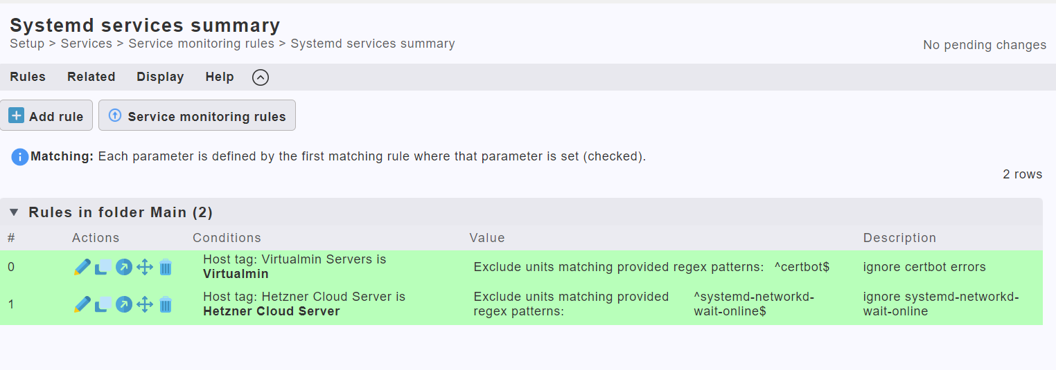

I have two systemd rules which are supposed to ignore cerain failure states:
the problem in this setup is, that only the first rule is applied, the second one is ignored. I could put both rules into one, but I have hosts where only one of the two should apply.
Is there a way to do this?
The Matching is defined so that the first rule defines the parameter.
You will have to come up with a better classification of your hosts in the rule condition, maybe a combination of both tags?
ok, I think I don’t follow, what do you suggest? (the goal is to have systems which ignore one service or the other or both having failed)
You should insert a third rule at the top of the ruleset matching both host tags and having both exclude patterns.
ok, this would work for two exclude patterns, but when adding more patterns, I would need to create patterns for all possible combinations, wouldn’t I? Is there a better way?
