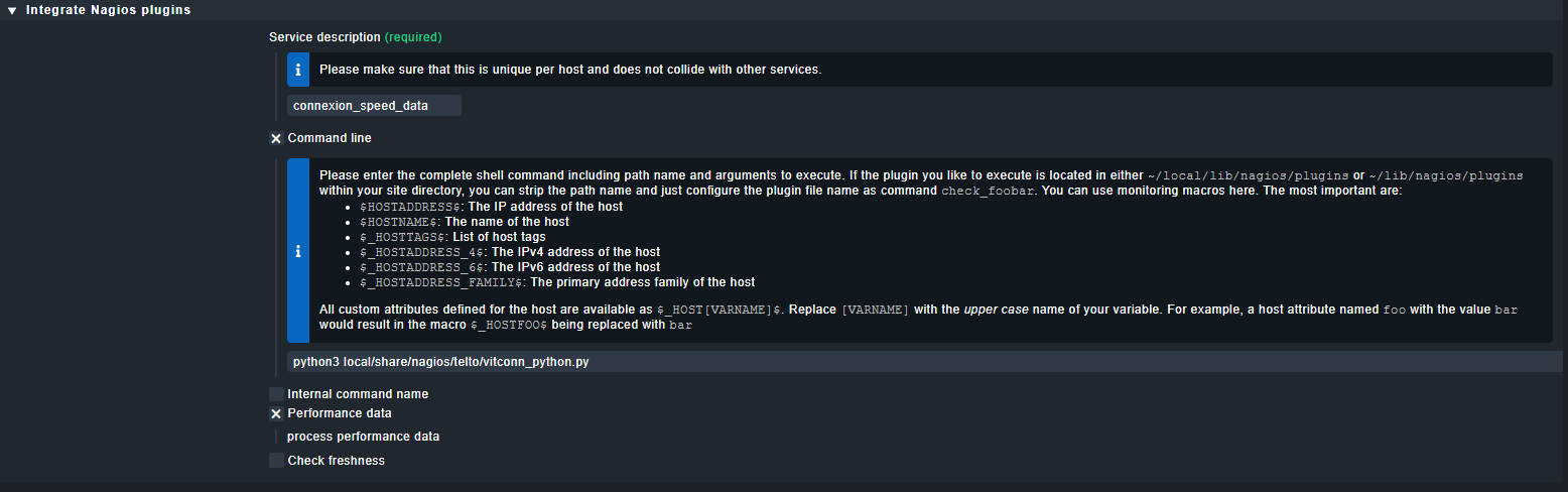

and i use it to execute my code :
@thl-cmk postet two examples of active checks in another post today, they also contain perfdata, you can take these as an example of how to output the data in the correct format.
I already suceed to get the perfdata in the correct format, but i cant apply it on every devices because the ip is written directly in the code it’s not a varible who change for every devices who start the script.
