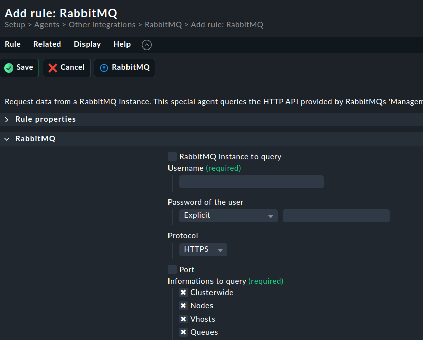

I’ve seemed to get nagios stable by disabling a bunch of rules and notifications and monitoring of rabbitmq
  • Which rules in particular were disabled ?
  • By rabbitmq monitoring, do you mean the OMD checks or Process monitoring ?

rabbitmq monitoring was the integration of rabbitmq rules to a host “Request data from a RabbitMQ instance”.
You mean this one ?
I tried creating a fresh 2.3.0p31 CRE site with those 2 python packages and a rabbitmq rule and updating to 2.4.0.cre works fine. Nagios Core still runs after the update.
