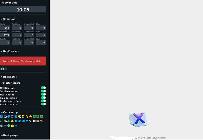

NagVis Map doesn't work since Update to 2.3.0p21
CMK version:2.3.0p24
Error message:LogonMultisite: Not Authenticated
since we updated our checkmk to 2.3.0p21 the NagVis Map shows “LogonMultisite: Not Authenticated.”.
I did my research already but didn’t find anything helpful.
When i click on the Map, it shows an error “too many redirects”.
We didn’t change the config of the NagVis at all. It just popped up after the last update.
We already updatet to the latest version p24 but the error is still showing.
Does anyone have a fix for that?
