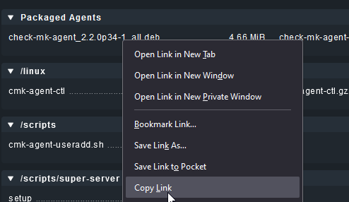

  2. Find the download link of the Debian package in your CheckMK server via sidebar menu → Setup → Subsection Agents → Linux
  3. copy link location of the ‘Packaged Agent ending with .deb’
