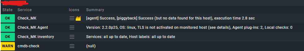

check_mk return (null) message in Summary field. However script working well in CLI. I do not understand whyi I think there is no issue with output format etc.

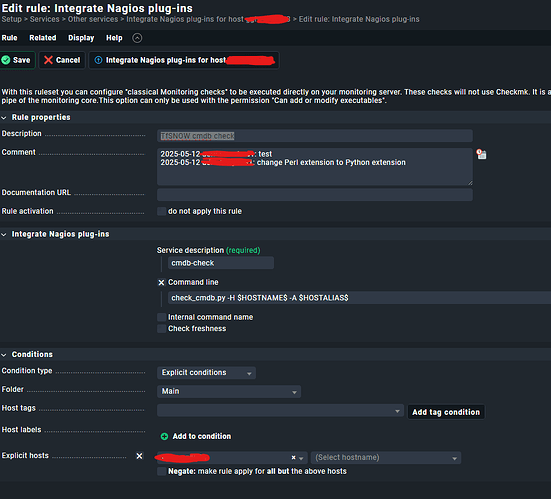

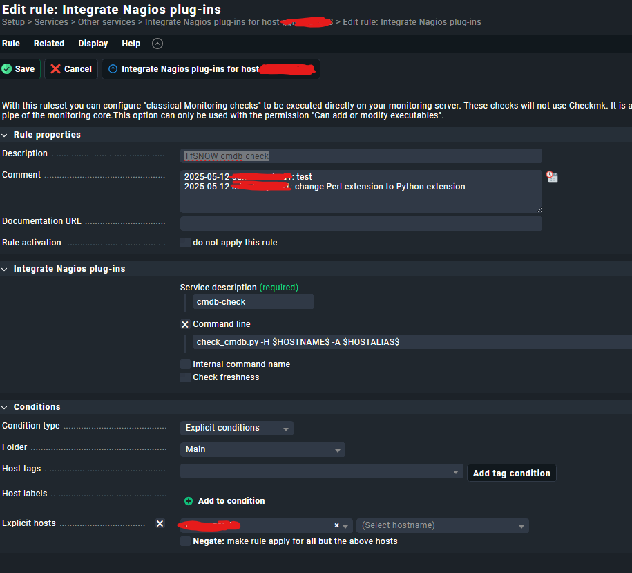

And here you have Rule defined in GUI for using that plugin:
Under host view it is looks lik that:

The output of check_cmdb.sh looks like a Local Check, not a Nagios plugin.
Thank you Robert for your answer.
Ok so I guess I should adapt output to typical Nagios format? Or maybe there is a rule somewhere which I should to use and stay with local check format?
You either want to run it as Nagios plugin (active check or via MRPE from the agent) or as Local Check from the agent. That depends on your use case.
