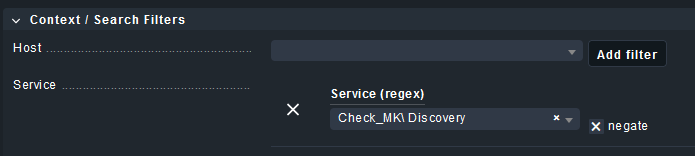

Hi Nico,
in Dashboard properties you can use Service (regex) and neagte it:
Best regards,
Marc
Hi Marc,
Wonderful! This answered my question.
Cheers,
Nico
