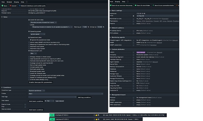

  • Well, in the attachments you will find the "Network interfaces and switch port " rule + the config of the device that i am testing + the service state ( before and after the cable unplugg)

Do you think you should then uncheck ignore operational state? Because having that enabled with ignore the up and down changes. I enable that solely for that purpose on some switches.

unfortunately, even after uncheck “operational state”, we got no change,
uncheck “ignore operational state” alone will force us to choose an OK status, which is not our requirement

the problem is solved after unchecking the “operational state”, however we need to reset the state of the interfaces, that discovered different at the beginning.
