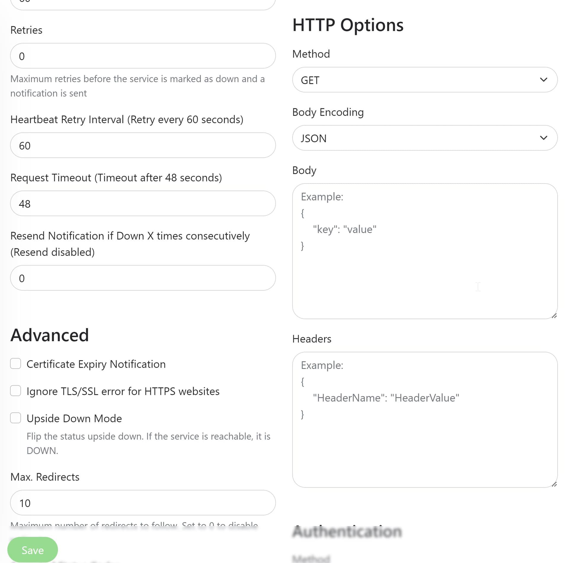

we want to use the new Check HTTP web service sensor to check an API that needs authorization. We need to send some headers with the request and i wonder if this is possible with this sensor? we basically look for these options which we have in Uptime Kuma:

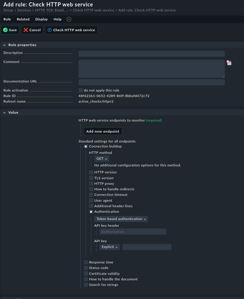

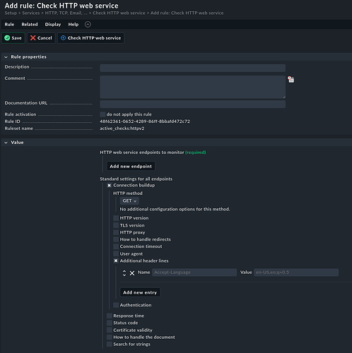

Yes, you can add additional headers in the HTTP check (see screenshot).
An Authorization header can explicitly be sent from the Authentication parameter also using a stored secret.
thanks, what is a bit confusing is, that you need to enter “Authorization” into the pre-filled field API key header. It should either fill it in automatically or warn, that it is still empty before saving. But it works after you fill it in, nice :slight_smile:
