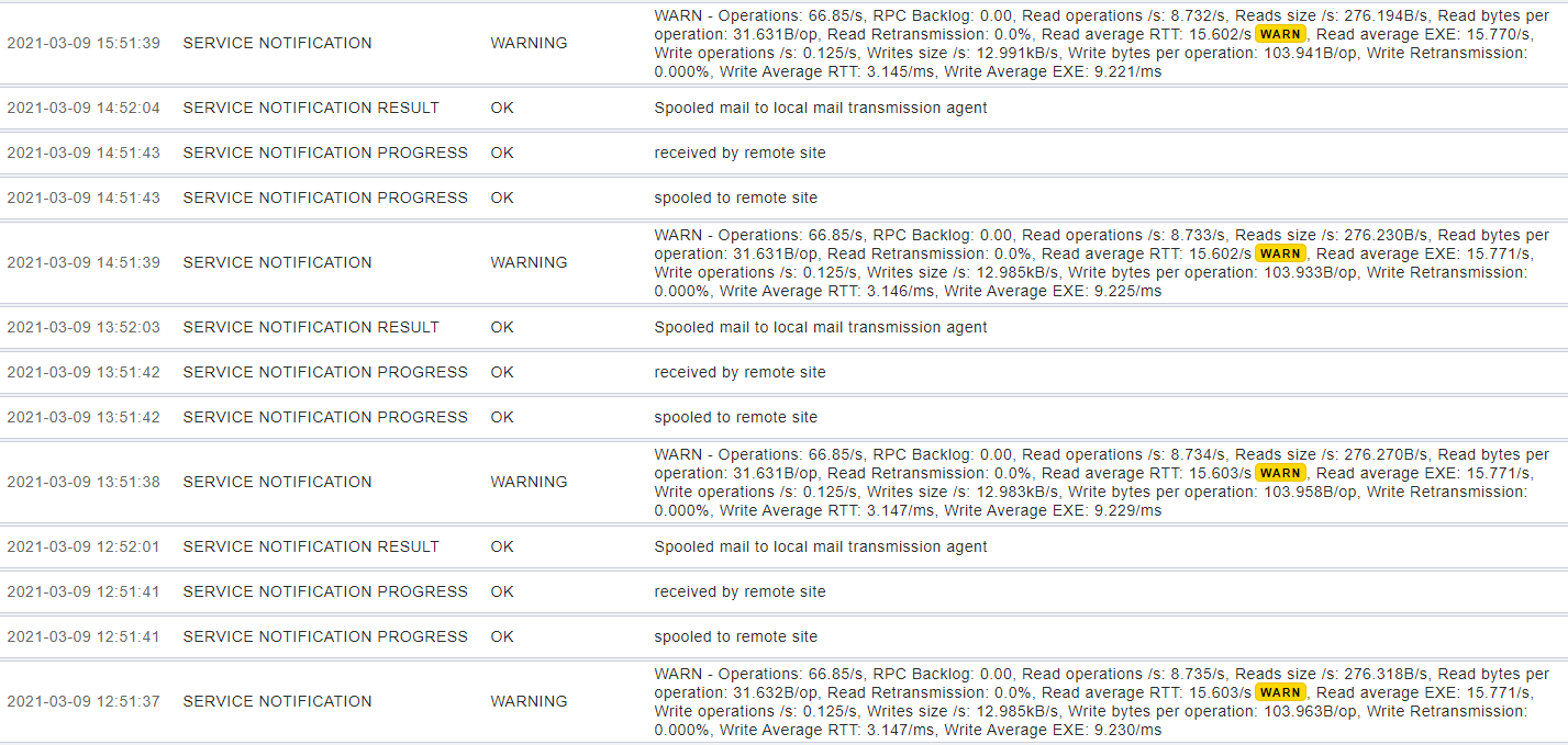

I have the following problem in CheckMk 1.6.0p19. By putting the nfsiostat script in the agent path on the CentOS 7.X machine there seems to be some problems:
  1. infinitely repeated values
ex.
  1. values expressed in seconds and not in milliseconds
ex.

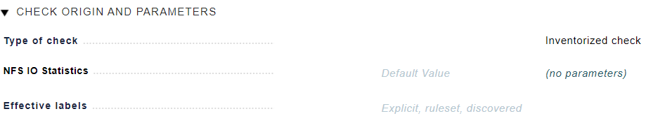

did you check the parameters for this service? Whats about the parameters for this service in service discovery? Looks like, that default parameter matching.
Cheers,
Christian

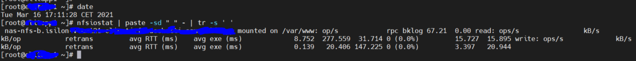

Hi @ChristianM,
Checkmk side no changes have been made. If I run the command
nfsiostat | paste -sd ' ' - | tr -s ' '
nas-nfs-b.isilon:/hosttest mounted on /var/www: op/s rpc bklog 67.23 0.00 read: ops/s kB/s kB/op retrans avg RTT (ms) avg exe (ms) 8.763 277.908 31.715 0 (0.0%) 15.728 15.895 write: ops/s kB/s kB/op retrans avg RTT (ms) avg exe (ms) 0.139 20.428 147.294 0 (0.0%) 3.398 20.956
checkmk detects
Incorrect conversion?

I had a look in the code. A problem will only raised when a parameter is set. Please check parameter of this service first.
Cheers,
Christian
Hi @ChristianM,
There are no parameters set.

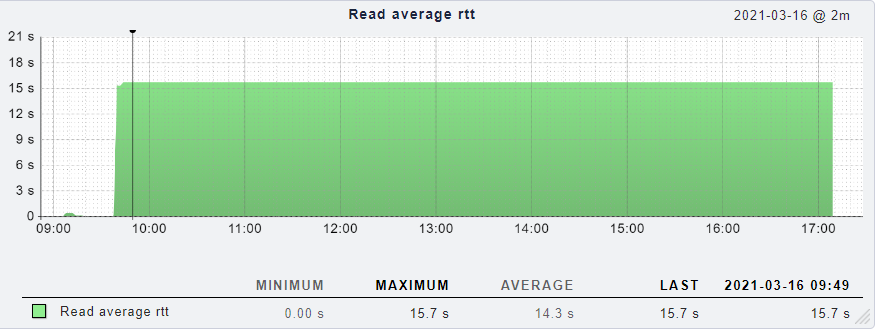

Another strange thing is that it seems that the values that it extracts are always the same as if it were keeping the data in cache, is this possible?
When checking the isilon the values go up and down and the measuring scale is totally different.
15.7 seconds is objectively too long as the unit of measurement should be ms.
Thx.
Dario.

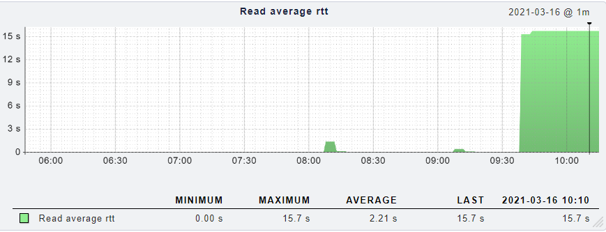

Hi Dario,
yes 15.7 seconds is to long, but if you look at the graph, you have a huge average. Whats about between 8:30 and 9:00, there should be ms.
Cheers,
Christian

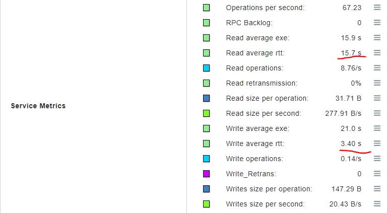

Hi @ChristianM,
If the command returns 15.728 (ms) why does the checkmk graph return 15.7 (s) ?
Another thing is that when we put the default script in place, the values it extracts are always the same.
Thx.
Dario.
