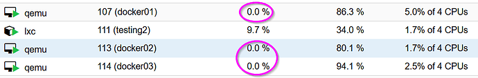

The disk usage is only available for LXC containers. Qemu VMs don’t have this data.
You see this also inside the Proxmox GUI, like here in this screenshot.
Thanks that makes sense. I guess in such case it’s better to install the agent on each VM.
