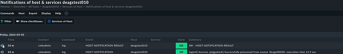

What I did to test is use the “Test notification” tool. Using the tool, I get notifications. But when a service status changes, I don’t get a notification.
As shown in the screenshot, there is no Service notification, just the alert.
Is there a new setting in the new checkmk version, preventing the notifications from being sent?

I just triggered the state again and the host is up since 30mins. Again the Alert is triggered but not the notification.
The last notification triggered is the host notification.

And this screenshot:

No notifications for services are sent out. How did you test the notifications on your side? Did I forget a setting for service alerts to trigger notifications?
The Warn Notififcation is triggered via “Test notifications” and works fine, i can find the entry of the tool in the nofify.log.
The crit alert is triggered via an actual event on the host, here I don’t see any notifcation and no entry in the log at all.

This is what the events table looks like:
And this is the nofitifaction table:
As you can see, only the “Test Event” triggered the notification.
