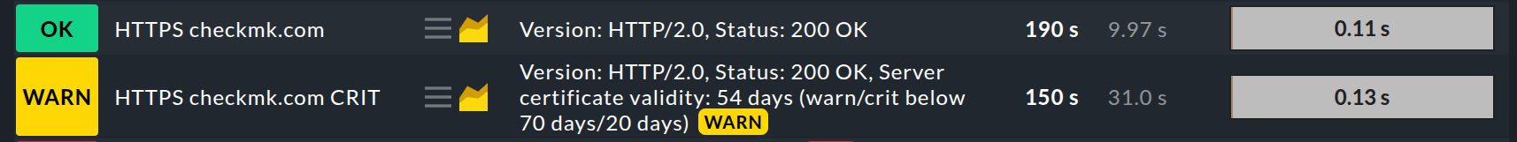

the purpose of the service summary is to only show the most important information. It is context-sensitive and will adapt it’s content based on the check evaluation, e.g. if something is critical, then the content is shown in the service summary. To ensure that the tables don’t get convoluted, we enforce again a more focused approach (vs. some years before, where no one looked in to detail into that). The tables are general purpose - if you have specific needs, you can adapt them to your needs as e.g. Janncek commented.
Example HTTP check:
The certificate expiry is only shown, if there is an action required from your side, e.g. you set thresholds and they are crossed.
If you want to always see the certificate expiry, then I also recommend the specific CERT service, which is an improved replacement vs. the implicit CERT service from the old HTTP check.
We finally fixed the service summary, details and graphs there (empty as I just set it up for this discussion).
