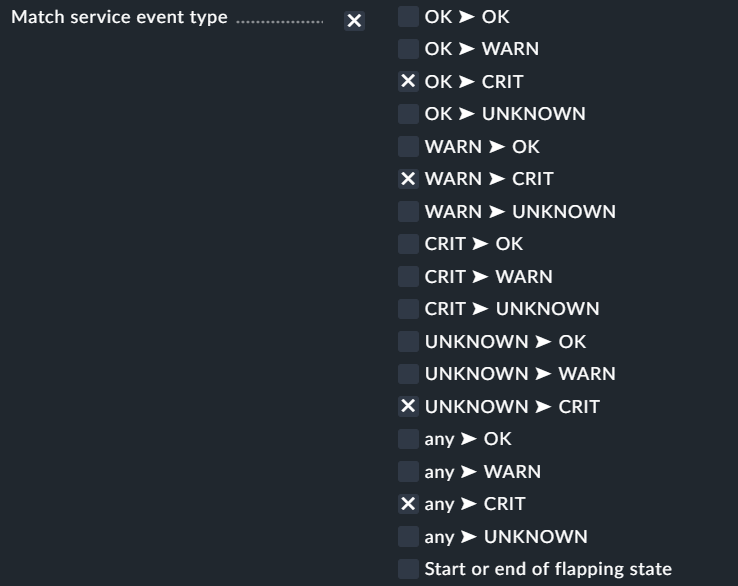

Inside the notification rule it looks similar but only with WARN instead of CRIT selected and the “Restrict to notification number” is set to “2 to 2”.
The whole configuration is not really intuitive but should work.
Thank you Andreas for the detailed description. I will try this out and come back to you!
So I tried it as described by you and so far, the CRIT notifications are sent as expected 5 minutes after the state change. Unfortunately the WARN notifications are also sent 5 minutes after the state change. The “Restrict notification to number” “2 to 2” doesn’t seem to work in this case.
