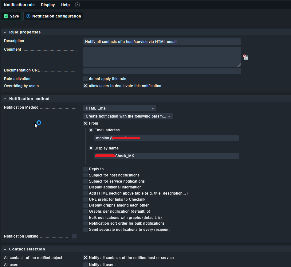

For me i’ve set up 2 types of notifications:
Both work without any issues on my end.

Ok, cool! Thanks! What did you set the email notifications to monitor?
basically everything, my setup isnt that big :slight_smile:
the rule is as following:
