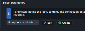

However I experienced that - for some reason I unfortunately can’t pinpoint - it is possible for the new notification_parameters you set in 2.4 to reference a parameter “object” that does not exist. In this case, if you edit the rule, the parameters dropdown will tell you No options available, but it is referencing something - you can see that because the Edit button is not greyed out:

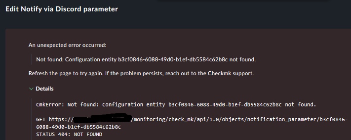

If you click edit, you’ll also get the UUID of the missing parameter set:
