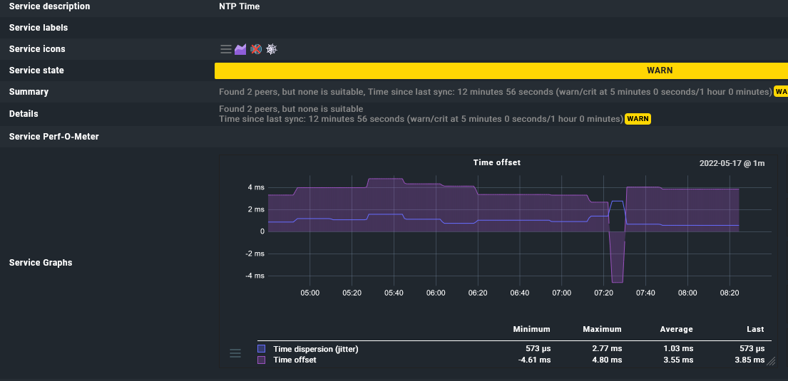

NTP Check does no longer respond with data
After installing the Appliance 1.5.0 and 2.0.0p24.cee the NTP Check does no longer respond with data.
Anybody else with this problem?
Log file on the Appliance:
May 17 09:06:56 v-ger-cmk-0001 dbus-daemon[548]: [system] Failed to activate service 'org.freedesktop.timesync1': timed out (service_start_timeout=25000ms)
May 17 09:06:31 v-ger-cmk-0001 systemd[1]: Condition check resulted in Network Time Synchronization being skipped.
Normally i am Monitoring out Remote Instances from our central site.
When changing it to monitoring itself, it doesn`t even detect a NTP Service.
